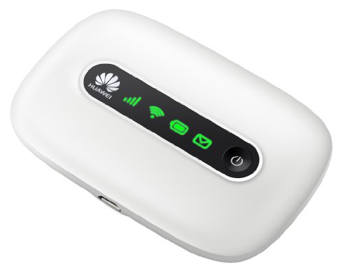

I connect to the Internet via minirouter http://ecx.images-amazon.com/images/I/315tRgnx5mL.jpg
