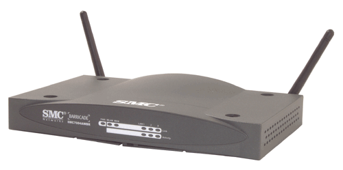

The good news is that I have a few routers laying around [SMC Barricade and a Lynksys or two] …wondering if I can replace the elnk altogether.

Looks like the Barricade is the bad boy of the two and there’s even a “wizard” in my web configurator to help me along the way. Other like-minded forums are all indicating that this is a proverbial cakewalk…so I’ll no doubt be stymied. Sometimes I feel like an ape with an abacus.
